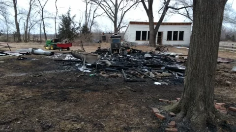

Have been running an EKO 25 for seven years and something happened. There was an explosion and shed was immediately on fire. Lost everything. Fire dept was quick and house was spared.
I need a new boiler. Should I stay with EKO or is there a better option now. Maybe something that doesn't need constant feeding. The EKO was fine but took some attention. Always planned water storage but haven't got it done.
Thanks

Sorry for the loss of your boiler and outbuilding Rugar. Glad nobody was hurt and your house was undamaged. Do you have any idea if the explosion was internal to the boiler or chimney, or was it possibly something stored in the shed that exploded? Scary.
Mike
Really unsure what happened. I checked furnace an hour or so earlier. Wife was within 15 feet of shed doing chores 15 to 20 prior to explosion. She didn't notice smoke or anything unusual. At moment of explosion she and our 6 and 3 year old were leaving house going to shed and heard explosion and everything was on fire. I don't recognize any problem with integrity of boiler or any compromise of flue as in burnt up or holes. There was a benzomatic self igniting hand torch for soldering and starting fires. Could it have spontaneous combusted I don't know. Hard to believe something was smoldering and took off that fast. I had been carefully to make sure no embers escaped and was burning oak that doesn't throw sparks. Had a double wall flue that attached to angle iron on one 2x4 and then poked through tin. 6 Inch stainless with a 13 inch outer shell. I'm at a loss of what happened. Fire dept and insurance didn't see anything to investigate
Rugar I wonder if you lost secondary flame for some reason and it built up a huge amount of gasses the lit off, my homemade "hybrid" does a small version of just that at times, I've had it blow fire out the peep hole in the door and flyash out the chimney when it does that, make one hell of a huff when it does it.

Cumminstinkerer you have the best theory I've heard so far. I've had the metal flapper by fan in front blow smoke out of itself at times. I'm guessing that is what your referring to. Always wondered if something could blow out at that moment but never seen evidence of anymore than smoke.

Maybe the Benzomatic leaked some gas. Could have happened if it's valve was made in China, worn, or accidentally not completely closed. I read an article once warning about keeping any potential source of flammable fumes away from a room with gas, oil (or wood for that matter) fired appliances. That included oil based paints, solvents, or anything like that with potentially combustible fumes.
I'm digressing, but it's a concern when people put wood boilers in their garage where you have gasoline cans and other sources of flammable fumes.

I have a Bernzo I keep beside my boiler too. Works great and love it. It's a push button one. I had one issue with it a couple weeks ago when I took it outside on a real cold morning to help thaw out some quick coupler fittings while hooking up the snow blade on our tractor. It sat on the ground for an hour or 2 before I went to use it (Had a breakage happen that required a weld job). Anyway when I went to use it the trigger froze in. It misfired & didn't light. So was spewing gas without control. Had to unscrew from cylinder & thaw it out under the tractor heater blower. Maybe the trigger stuck/froze slightly open on yours?
I was just going to say the same thing. I have used my torch out in the cold and then it "freezes up" and won't shut off completely until it gets warm...if the flame went out but the gas was still flowing...well, you know, BOOM!

I don't believe the boiler exploded. In fact I'm willing to bet my brother in law's paycheck on it. In order to get BOOM you need to confine the area of ignition tighter than the EKO is capable of doing in order to create that much pressure. You have a large 8 inch flue plus an air intake plus the doors would quickly relieve any pressure with the slightest outward bend. You'll get a "PPPFFFFFFTTTT larger and louder than you want to hear in the worst case. That is not to say that you won't get some smoke or maybe some flame into the room.
I had some wicked explosions with my Wood Gun and was darn glad I had my flue pipe screwed together well. It was just the task of running around to pick up the blown off pieces and re-attaching to the boiler. Intake pipe, etc.
I'm guessing you had a propane leak.

Do you think a small propane bottle with a leak could get the fuel to air ratio close enough to get a boom? With a boiler sucking fresh air into the room. I am not saying you are wrong. I just don't know?
I did hear of a guy blowing up his garage when he set a can of spray paint on top of his wood stove.
Yes. Looks like a pretty small building. My EKO 25 moves very little air. It would take a lot of time for the EKO to purge the air in that space.
Sorry I haven't been available much this weekend. I will get some closer pictures. I don't think the boiler is compromised other than controller, fan, paint, sheet metal, insulation and wiring. Fortunately I have replacement cost insurance and boiler was listed so I guess I have to buy a new boiler. But I think I will keep the old one to use again somewhere.
