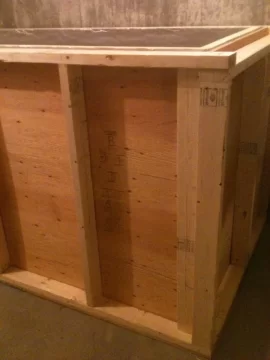

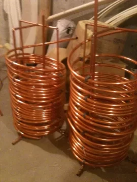

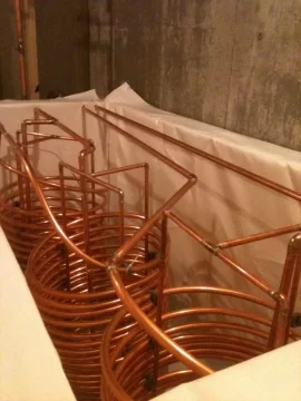

Pressurized is the way to go these days, but if you can't You could build your own. I did it and it works great. Tarm used to sell unpressurized units but it doesn't appear they do anymore. I know building your own and using EPDM for a liner isn't top shelf but it does work when you are limited to space. 8' x 8' x 4' You can get enough water in there for about 1200 gallons. Mine is in my basement and my boiler is in my attached garage it's 100 feet in pipe length away. Good luck and enjoy figuring out all the kinks it's a lot of fun (if you enjoy that kind of thing)?

Woops sorry didn't add explanation this was my first design
I bought the liner custom made I had moisture escaping from the cover from not being properly sealed. I decided to make it bigger and when I opened it up the liner above the water was brittle that's why I used EPDM the second time
Same design just double the size w a extra coil and better reinforcement
I don't have pics of that being built

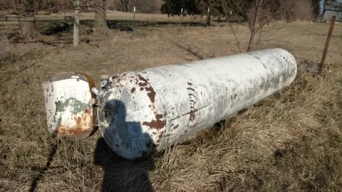

Rugar, how about a picture of your "very long 500 gallon propane tank" too?
I'll try to get a picture of tank today. Someone also makes a garn like boiler that has pressurized storage around it. Don't remember the name. These type of boilers may be pushing the amount of dollars I can spend. I hope the Froling sale isn't gone, will make things tougher if so. My biggest concern is I needed 180 plus temp water to heat my baseboards and be comfortable. When temps dropped to 77 or lower it was noticable.

This is my propane tank. Touch longer than 13 ft and 2.66 ft wide. 500 gallon. Wish I had two. Gotta be great for stratification when placed on end.
  • [Hearth.com] Need a new boiler EKO 25 died in fire.
