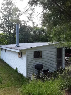

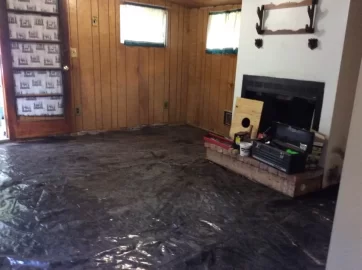

Not a masonry chimney, steel pipe, goes straight up thru ceiling. I would like to use the same location, installer said new pipe needed. Pics attached.

Got it. So is the plan to tear it out completely?
Of the stoves you have listed, the 13-NC has the largest firebox and it's made in the US. It's been around for a good long time and should be trouble free. One thing to consider however is the chimney height. The 13NC is going to want about 15' flue system height from floor to chimney cap. Another stove to consider is the more modern Englander 50 SSW01. (Also sold as Summer's Heat brand). It's a bit larger and has turned out to be a good heater. https://www.lowes.com/pd/Summers-Heat-2000-sq-ft-Wood-Burning-Stove/999918844

Yup, plan is to tear it all out, (the old one sits on rotten plywood, and I may need to repair the sill plate and studs behind it. The wall to the left of the current set up was bad, plate to right of it is solid, so no telling where the rot ended / began)
