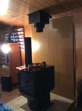

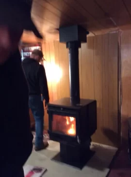

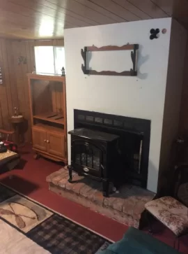

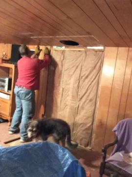

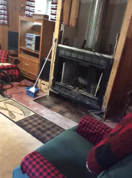

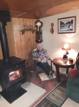

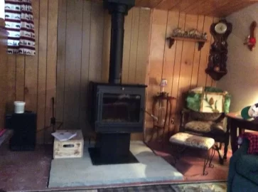

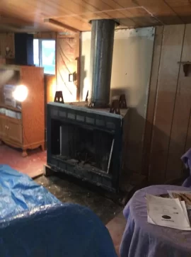

So, after a lot of prep work, some planned and most not the new stove is in. I had replaced a rotten floor that was over a concrete slab. I removed the chase that encased the old pfefab fireplace and relocated or removed electrical outlets and switches. After the old fireplace was out, rot was found in the wall behind it, so I rebuilt that. Then some emergency roof repairs were required ( will need major work next year, but that's for another time) We finally were able to have the installers in, they put down 2 slabs of bluestone over the slab and installed stove and chimney. We have had one break in fire so far. I am impressed with the heat output ! Here are some phots that show the progress from beginning to end. The last photo shows my wonderful Mother in Law enjoying a glass of wine, sitting in a rocker and being kept warm and dry by the new stove, this is what I wanted !

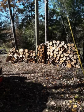

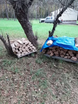

Now to finish getting wood ready. What's been split is cherry and oak. What is stacked but not split is a mix of ash and cherry.
