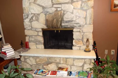

Thank you all for the advice so far! I attached a photo of my fireplace, and the approximate dimensions are as follows:
It is 22.5" deep, the opening at the front is 34.5" across, and at the back it is about 27" across. The opening is 25" tall. It is 21" on both sides from the side of the fireplace opening to the edge of the rock chimney. The "shelf" in front is 17" deep.
When I try to read some of the dimensions on the websites for the different stoves, I get a bit confused if my fireplace would take the insert.

Welcome Autumnknight. I think you would be happy with a mid-sized Quadrafire 3100i or PE D1 insert. I agree with Warren that you may want to consider a bit larger than the sweep suggested. You can always burn a smaller fire, but when it gets in the teens or lower, you will be glad to have the reserve capacity. And the 3100i is almost 4 times cleaner burning. The same goes for the blower option. Get one, even if you run it on low it will help circulate the warmth and in the shoulder months you don't need to turn it on.

Well. I have the PE D1 insert. You may run into front clearance issues since the "shelf" is only 17". I would suggest finding a flush insert and getting the blower. you may need to extend that shelf or add a non-combustible surface to the floor in front of the hearth otherwise.
