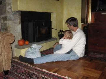

The guy who came to give me the bid on the install said that with the way the rocks on fireplace are, that they would either have to custom cut the plate, or I could get a mason in to cut part of the rock away. See the photo, though it may not show very well, but there is a large stone immediately above the opening that juts out a bit....so the concern would be a gap around the insert....
Do you think this is a big deal? It sounds like it would be fairly expensive to custom cut the plate, and I have no idea how much it would cost to trim the rocks. It seems that what I thought was going to be a fairly easy decision has become complicated by a lot of fairly expensive additional concerns.....Or maybe the gap wouldn't be that big of a deal?

If you make sure a block off plate is installed, then the gap around the surround is no big deal. Hell, with a masonry blade and a saw, you could prolly cut it straight yourself. I didn't notice any photos?

There are two plates that are sort of involved. There is debate about one of them as to exactly what code requires, but there are lots of stories to confirm that for heating it is essential. This is the "blockoff plate" that Hogz was mentioning. It is a plate that goes up inside the flue, generally in the former damper area, and which seals the gap between the liner and the chimney. There are descriptions of how to make one in the wiki, and I would advise letting the installers know that it is a required item.
The other plate is what fills in the gap between the insert body and the edge of the fireplace - this plate is called the "surround", and as long as you have a properly installed blockoff plate it is primarily cosmetic. Some installers like to try to avoid putting in a blockoff plate (it is a PITA) by sealing the joint between the surround and the fireplace opening. This is definitely a lousy way to do the install, it will send a lot of your heat up the chimney.
Doing a proper blockoff plate will allow you a lot more flexibility in handling the surround as that joint is no longer a critical area. I would probably trim the plate to fit around the stone rather than cutting the stone, but you will have to decide which way to go with that in terms of the look you want.
