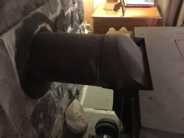

The stovepipe is 8" diameter before entering the thimble. It exhausts out of the back of the current unit (see pic). The chimney is at least double walled, outside the house, has a clean out at the bottom, and a cap at the top. It is currently clean and free of debris/creosote. The chimney exhausts above the gable of of the house.

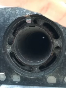

No, I pulled the clean out panel at the bottom of the chimney and measured the inside diameter, and it is 8".

It's going to be a challenge to match that setup because the rear thimble height controls the stove choice. I would look again specifically at the Woodstock Ideal Steel stove. It has adjustable leg height which may help solve the problem. Starting at around $2k it is reasonably priced. Otherwise this may take relocating the the thimble much higher for a top venting stove.

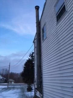

To answer your question, the chimney is two-stories high; I am guessing 20-25 feet tall. Please see pics.
I also included a pic of the chimney from the bottom, with the clean-out access panel removed. Looking at the pic, the sky is the little blue dot in the background. Is this the double-wall Class A chimney that everyone is mentioning? If so, good news.
FYI: The inner diameter is 8", I measured it this morning.

The pictures of the chimney look a little.....rough. Have you had anyone out yet to inspect the chimney itself? If not you may want to consider it. It looks like it's been there quite a while and it doesn't appear to be stainless but I can't tell for certain. Better to be safe.
Looks galvanized as far as I can see.
Yes, it is galvanized. If it was installed at the same time as the Sequoia, it is 20-25 years old.
I had it cleaned in November, and there wasn't much in it. I would definitely have it inspected before getting a new stove, that's for sure.
