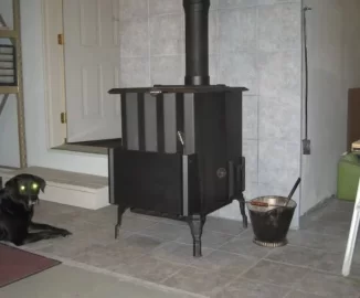

I would consider having the thimble removed and placed higher so you have more options? This may be done without major expense and would provide you with many more stove options. With the thimble that low it really limits the stoves to rear output or small top outlet stoves. Maybe you could have an estimate of what it would cost to move the thimble and see if it’s worth the extra cost? If it costs $500.00 to move the thimble higher it would be better than spending that money on the install as you could do it yourself with the proper guidance? With the higher thimble your options aren't limited and no matter what stove you put in, it will perform more efficiently with a better draft.

I've been looking at inserts, and around here all the stove shops are charging between $400-$500 for install not including pipe, parts and even gas milage. Maybe you could do it yourself and look into some local metal/welding shop to fabricate something to hook the stove up?
I have to somewhat disagree about moving the crock - it is pretty expensive in most cases - but, even worse, you have often added one additional 90 which negates any improvement in draft and usually turns it the other way.
