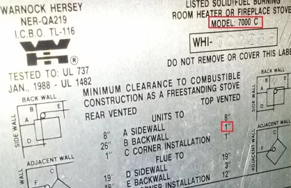

I just got a Sierra 7000C for $300. It came with about 12 feet of triple insulated pipe (what he called it) A wind baffle/cap, some insulated piece that goes where it passes through the ceiling and some regular stove pipe.
It evidently has a heat "jacket" that allows for a rear clearance of 1inch !?
It LOOKS to be in good shape (8 of 10 maybe)
I guess you can tell from my lack of proper terminology that I don't know what I am talking about!
I just used the info from the tag to identify it, but I can't find SQUAT online!
If anyone has any input at all I would GREATLY appreciate it!
Are they decent, or junk, or "only a fool would pay $300 for that pile of $@#! :)
It's still in my truck, so if it's garbage I can give it back!
Thanks a ton for ANY insight at all !!

1" is really close! I've installed 1 "zero clearance" UL listed stove, I'm not sure of the brand though. Do you have a picture of the front?

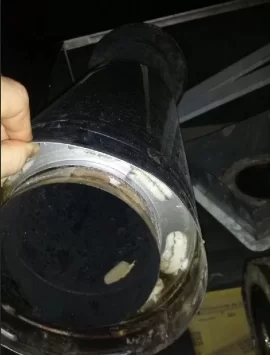

We could also answer any questions about the pipe that you have, if you can post a pic of that as well. If it's class A, it's hard to go wrong for $300.

Even though it SAYS 1" I would err on the side of caution and gitve it more than that :)

Here is one of the sections I got... that's a mud dauber nest inside of it :)

1" isn't that unreasonable for a corner installation, since only a small part of the stove (that corner) is that close. That's one of the nice things about a corner installation. Still, going to 2" would hardly make a difference in the space used.

I will be placing this backed up to a wall and NOT a corner. It looks like the tag still says 1" clearance.

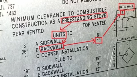

Better read the plaque again though, before you do the install. Looks like 26" backwall clearance to me.
The pipe is good for 1"

Good catch Dune however where this stove is top vented it looks like 3" from the flue to the backwall to me.. Actually it's pretty confusing almost over explained lol..

Thanks Dune... I just looked at it again, and as I read it, if it's top vented, I can be 1" from the wall. You would know WAY more than me, so please know that I am RESPECTFULLY pointing that out :)
The only way I can use it in my home is if I can have it no more than 6" or so from the wall. It DOES have a heat shield.

Yep, my eyes are not helping me today.

OK I am officially insane now.. Don you're correct from what I can see it's 1" from back of stove to backwall and 3" from flue to backwall.. Gonna be hard to type with a straight jacket on! !!!
