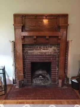

We are redoing the fireplace in our 100 year old bungalow. Tasks are:
1. Replace mantel with period antique mantel made from beautiful quartersawn white oak. The mantle has hollow columns that need to be filled with something.. my thought was brick that works as hearth / shield (see pics)
2. Have attractive stove professionally installed in fireplace. (Must meet standards set by the Committee of Wife Decor)
3. Add beautiful art tile from Motawi tile to replace ho-hum brick
  • House is 1.5 story built in 1920, with 2300 sq ft, (1500 ft down / 800 ft up - finished attic)
  • Heating needs are supplemental, we want ambiance of fire
  • Though.... 6' from the hearth, in the wall, is 18" 2nd floor HVAC return... we could tap into that to get stove heat circulating
  • Stove room is 14x18 living room connected to 16x14 dining room via 4' opening
  • We have a new 100K BTU LP HVAC furnace with variable speed fan that does a great job.
Jotul F3CB in BBE is what we have our hearts set on after much research per my other thread. If a F400 Castine fit, we'd go with that.
We are stuck at #2 because of clearances. We are having a hard time finding someone who will think through shielded details with us (seems backyard fireplaces are much more appealing than wood stoves). We have spoken to 2 installers so far... they want to go insert or with something that doesn't need shielding or pull the stove so far into the room, there are horizontal draft issues.
The fireplace has a ~3" smoke shelf opening to the flue. The flue inner dimensions are 7" x 14"
Thanks for any help with the shielding requirements per pics below (and shield value of brick extension if we go with that.)

The Craftsbury is a cast-iron stove, not jacketed. It's 22.375" wide and has 14" side clearances to combustibles, 36" top clearance. The 41.5" width between the mantel legs is shy by 9" needed and the 50" mantel height is 10" shy of the clearance required. There would need to be shielding extending out all around the fireplace opening to make this work. Is that ok?
Thanks begreen. Page 9 of the manual explicitly lists fireplace install of 8" to side trim clearances, 14" to mantel. Wouldn't this work?
STOVE .. Width. x Height x Depth Clear MANTEL TOP SIDE >= MIN OPEN W X H (TRIM/MANT)
CRAFTSBRY PDF 22.38" x 26.13" x 17.38" .. 14" 10" 8" >= 38.38" x 36.13" / 40.13"

How deep are the mantel side legs? 18" + 22" = 40 so if they are less than 4" thick you are good on the sides. How deep is the mantel shelf? 18" + 26" = 44". The mantel shelf looks ok but it looks like the heavy brackets are below that requirement. Maybe discrete mini-shields on the bottom of the two middle brackets would help?
