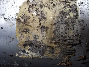

Post a pic. We may be able to ID it.

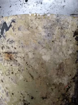

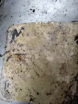

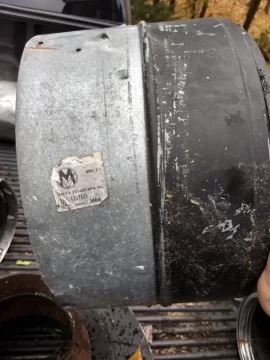

it also says Model D Issue 146A if that helps

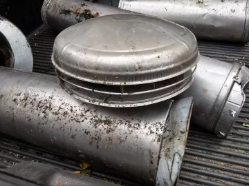

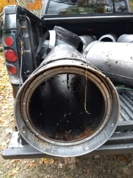

It looks like class a chimney to me. But it also looks pretty old and beat. I wouldnt use it if it was my cabin
I think you are right about it being old...and beat. There are four good sections out of the six. would it be suitable to run outside the wall? What is it about it that you would be hesitant to use? Would it present a safety issue?
If that insulation is compromised yes it could be a safety issue
I see. So where this is a free offering I would like to salvage it if I could but only if it can be salvaged. How would I determine if the insulation is actually suitable for use or not? I appreciate what you are saying I am just trying not to turn away a free item if possible.
It turns out that one person's trash usually isn't someone else's treasure, in most instances (this one included), it's just trash.
The fact that you said it was heavy is not a good sign. I dont know of a test you can do though.
