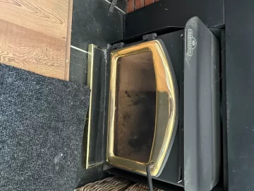

Hi everyone,
My grandfather has an older Napoleon wood stove. I believe it was installed in the 1970s-80s. Would it be safe to assume it's not EPA-certified?
Thank you!

It might be a model 1101. Does it have a secondary rack running up the center of the baffle? If yes, it is an EPA stove.
Note that install is not proper. There needs to be at least 16" of hearth in front of the stove door.
