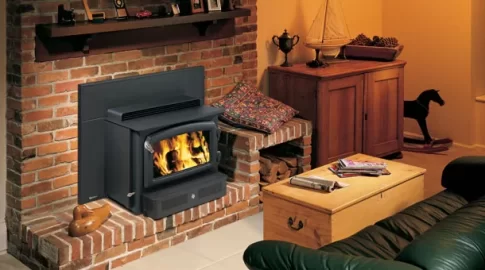

[Hearth.com] Need help in choosing the right insert
Regency Classic™ H2100 Hearth Heater Wood Insert
I'm brand new to this forum and definitely new to using a wood burning fireplace insert. Have been doing a bunch of research on the internet to the point that my head is about to explode. Here’s what I’m wanting to accomplish: 1. Keeping the DIY cost for units, liner, etc to around $2K, 2. Am heating the main floor of our home which is about 1600 sq. ft. 3. I would like to keep the heat in the house versus heading up the flu thus the model above photo 4. Am leaning toward non-cat. 5. Am likely going to be burning mostly seasoned soft wood from pine trees cut down and split 1 1/2 years ago (any advice?)
Am currently leaning toward something like the pictured unit above which looks like a hybrid stove/insert. Does anyone have a review of this particular model? Any thoughts or recommendations for a first-timer? Also how difficult is this kind of installation? I’m pretty handy but have never installed an insert before.
Thank you.

Based upon your price point, you'll be going with a budget stove, like I did, unless you find a used stove.
You'll get good guidance here, just ask.
It's daunting to do it yourself, but usually do-able.
The stuff I found the most challenging included cutting the damper out (not difficult to do, just intimidating), and the roof work, because the roof is steep and I was scared.
And everything was, for the first time.
You'll want to get up on your roof and measure the chimney opening and take pictures.
Also measure your fireplace, front to back at both bottom and top, sides to side at front and back, and bottom and top. All dimensions of the opening, and take pictures there, too.
Here you can find a few budget options. I went with one of their kits, and only needed to buy liner insulation and a little hardware to complete it
https://myfireplaceproducts.com/us_en/heaters/inserts/wood
