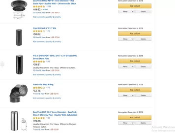

So this will be my new crock? and just buy duravent double wall pipe going from stove to it?
https://www.amazon.com/dp/B01CFMCNPA/?tag=hearthamazon-20
Would these be the correct parts/piece together?
Do I need another adapter for the top portion of the stove itself?
Thanks for all the help, the single-wall pipe is straight forward and easy but this double wall stuff has many different adapters etc
I don't work with duravent products so I really don't know. You will need at least one telescoping section though because you can't cut that pipe to length.
Duravent is fine also Selkirk they are both have decent cheaper pipe. I use ventis or excel

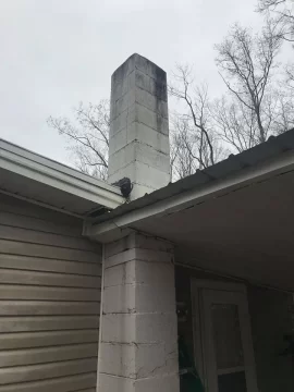

Question - how thick a wall will this be going thru to hit the masonry chimney? Would a 12" section of class work? And secondly, is there going to be a sleeve needed to maintain 2" clearance to combustibles from the class A?

I can't answer what length is needed through the wall 12" would probably do. But no sleeve is needed it will be mortared into a block wall.
OK, by the picture it looked like it was going through a conventional stud wall, but I haven't been following this thread and missed that detail buried in previous comments.
It is in the basement. I am pretty sure but now I am second guessing that

The wall it is passing through is all non-combustible correct? If not I was off base this entire time and you need a different solution

No, this room was actually a porch that was enclosed at some point. It looks like I can cut around the inside wall and expose the cinder blocks the clay crock is coming out of. 6" is minimum clearance i'll have from all combustables

Np, this room was actually a porch that was enclosed at some point. It looks like I can cut around the inside wall and expose the cinder blocks the clay crock is coming out of. 6" is minimum clearance i'll have from all combustables
so I don't think i'll need the sleeve just the pipe itself to replace the crock
That is a critical piece of information. Double-wall stove pipe is for interior use only. It can not pass thru a wall.
Something like this is what is required to pass thru a combustible wall. (standard stud framing)

Good idea. The manual shows on pages 26 & 27 the options, though actually if this is a stud wall there is not enough room there to have 12" masonry on all sides, thus the thimble.
