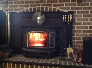

I say go bigger. My Quadrafire 4100 insert is not enough even with the built in blower for my 1900 sq/ft ranch even though the dealer said it was. Maybe a stand alone stove give different results.

Wondering if this is a case of heat loss.
Is the insert on an exterior wall? Is there an insulated blockoff plate in the damper area? If exterior, is there some insulation between the insert and back of the fireplace?
Do you have an insulated block off plate? Insulation behind the insert?
Reactions: Merc1973
Its in a brick fireplace with brick chimney on exterior wall. I'm not sure what's behind the insert since I was not there when the dealer installed it.

Definitely, a free-standing woodstove heats more effectively (and efficiently). You could probably do better with the stove you have if you had a stronger draft. That's makes a big difference. Oh, yeah, and like the others have said, minimizing masonry acting as a heatsink to the outside.
There probably is no plate or insulation most installers don't do it.
Only if it sits out of the firebox if it is inside it will actually be worse than an insert in most cases.

Yes, that's what I would guess too. If so, adding a block-off plate and a bit of insulation behind the insert could make a notable increase in heat output. This is of course assuming that the wood being burned is fully seasoned and that the wood is not the issue.
Thanks, if i can figure out how to remove the surrounding plate, i will add some insulation, fiberglass batts?
No it needs to be noncombustible. Mineral or ceramic wool. The biggest diffetencevwill come from a block off plate. Which usually means pulling the stove out.
Reactions: Merc1973
Block off plate at the top between the flu and brick firebox? Sorry to the OP for the temporary hijack.
