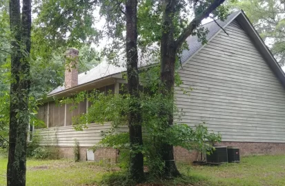

Some examples.
Similar pitch, outside wall location.
8.5ft exposed, plus porch, plus inside.
The porch cuts off some of the outside exposure.
I visited the place 5yrs, and hadn't paid attention to noticing it until I made it a point. It's around back, where it's not a focus.
