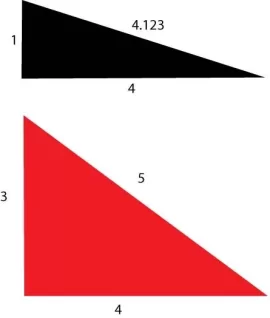

A 3:4:5 right triangle is just one of the ratios that can be achieved with a right triangle. It does not define a right triangle. Tell me how a 8' x 16' sided triangle fits into this rule where side A= 1, side 2= 2 and the hypotenuse = 2.236. If multiplied out that becomes a 3:6:6.7 triangle.
Or what if both sides are equal? Then 3:4:5 doesn't apply at all. If the shed were 8' x 8' then the hypotenuse would be 11.31. I'm not a math genius by any means, but this is common sense.
Here's a graphic aid.

BG, all I'm saying is that you said "not 3:4:5 compliant"...of course not every right triangle is a 3:4:5, and of course there are an infinite number of other configurations...all I'm saying is that the 3:4:5 rule can be used to verify whether or not a corner is square. Stand at the corner, measure one way 3 somethings (don't have to go all the way to wherever it goes), make a mark, OK, now measure the other way 4 of the same somethings, make another mark. Now measure the distance between the two marks. If it's 5 somethings, you've constructed a square (right angled) corner. That's it, that's all there is to 3:4:5. Rick
EDIT: I never said 3:4:5 defined a right triangle...I said it defined a right angle.
Ah, now I've got it Rick. I didn't apply that rule when setting up the shed because although I had a square corner, that didn't mean it was aligned with the opposite one. But you are correct. I guess I just had different carpenters teaching me. We always measured and equalized the diagonals.
