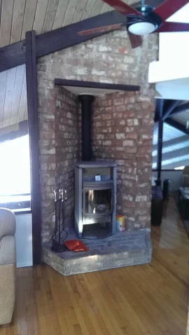

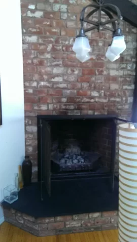

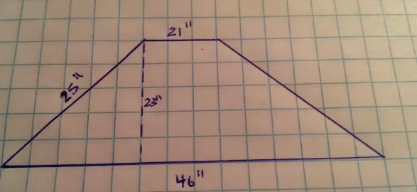

I posted a thread around October last year looking for advice regarding a fireplace insert to compliment our mid century modern home. Just to recap our house has a very open concept, a lot of windows somewhat drafty and not well insulated. We currently have a RAIS Atlas wood stove that came with the house on the main level of the house and opposite that we have another fireplace. The original plan was to place an insert in the fireplace and use the insert for most of our needs and if needed use both in tandem. A several members suggested to replace the RAIS wood stove with a modern EPA wood stove with a larger firebox and forget about the insert. Since then I have been doing a lot of research on the forum and come to the these conclusions:

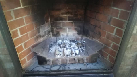

1) Based on on our fireplace dimensions it would be very difficult to get a decent size insert; although we have the height and width the angle of both sides taper in too much which I think would be a hindrance in placing an insert. Please see picture to see if I'm correct in my assumptions.
2) We would have to have the fireplace chimney lined and insulated- so additional cost
3) Would the insert be able to provide adequate heating? We have oil heating and would like to significantly decrease out consumption. Realistically, I don't think we will become oil independent just because of the total sq. footage of the house (approx. 2500) and insulation, glass etc.
4) At this point, I agree probably the most functional and cost effective approach is to replace the RAIS with a modern wood stove.
Having come to this conclusion I have some further questions:

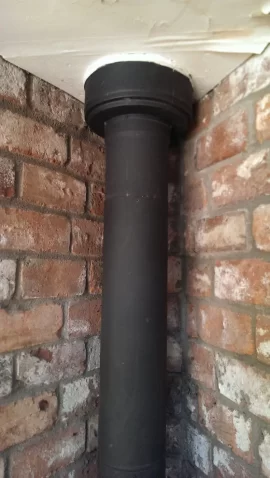

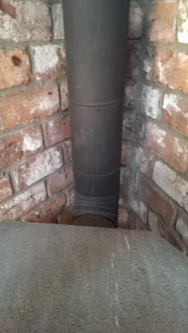

1) Can I use the existing chimney pipe and setup and just swap out the stove? Based on the RAIS manual the stove pipe is 6 inches.
2) The RAIS stove has a rear pipe connection and most of the stoves we are looking at have a top connection.
3) Since the pipe is coming from the back portion of the chimney and the new wood stove will not be directly below, how should I approach that? Two 45 degree bends, 30 degree bends, or 90 degree bends.
4) What are your opinions regarding the Drolet HT 2000? In terms of complimenting the style of the house would it just look "weird"? Although I would like to purchase something more modern, I am afraid to spend around 3K and find out the wood stove is not accomplishing our heating needs.
5) My plan now is to have our wood burning setup ready for the 2015 fall season. Are there a lot of sales, discounts for stoves during the spring and summer months?
I have a attached a few pictures here and my older thread has pictures of our house to give you a better idea of the layout etc. The older thread is under "Need Help: Advice on Fireplace Insert for Mid Century Modern Home"
I am a novice when it comes to wood burning so please bear with me. As always, thank you for taking time to read this and offering your advice.

You can use the exisiting chimney pipe as long as it is in good condition. Might be wise to have it inspected by a certified sweep with a camera. You can use whatever angles you need to to make the connection, you just want to use as few as possible and minimize the angles if possible. Thinking two 45s might be best. As far as style goes, that's all personal preference. I would just make sure you size the stove appropriately for the house.

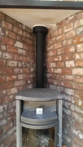

I see that the brick work has been customized for the shape of the RAIS, so you're going to have to find something that will fit into that space with at least 3 cu ft. capacity before you do anything else. Some stoves will offer interchangeable rear as well as top flues, so dig a bit on specs rather than just look at the pics. Both my stoves have that feature.
I would judge the existing 6" chimney on how long it's been there. I had a lengthy discussion with an inspector about doing a video inspection of mine and he was very clear that he tried it and it was not worth it. They can't see problems that might be there and so they refuse to certify anything after it's 25 yrs. old. No idea what you might find your area inspectors would say. If in doubt, replace it. It appears that there is water damage on the ceiling near the chimney and that might indicate water has been getting it for quite awhile.

"I see that the brick work has been customized for the shape of the RAIS, so you're going to have to find something that will fit into that space with at least 3 cu ft. capacity before you do anything else. Some stoves will offer interchangeable rear as well as top flues, so dig a bit on specs rather than just look at the pics. Both my stoves have that feature."
All of the fireplace chimneys are triangular in shape when viewed from the outside, we have 4 of them in the house. Try too imagine a triangle with a nook carved out, that's where the RAIS stove is currently in. I can fit a larger stove in the area, it just would not be as recessed back in the nook as the current setup.

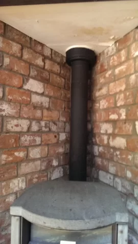

I'm more than likely going to replace the stove pipe and fix the ceiling area where the leak occurred, it's been there since I moved into the house. I wanted to do everything together. If I were to replace the stove pipe, I'm thinking double wall stove pipe? Any brands that forum members recommend? I see a lot of adds for Duravent and Selkirk.

I've never seen a flue or celing support installed with such tight clearances and would want to know what is behind that brick. The Rais is a very high quality stove and a modern design. It is undersized to heat the whole house. Still I would hang on to it if possible.
The fireplace is a bit quirky. One option would be to take the current hearth down lower and extend it so that a freestanding rear exit stove could be installed in front of it.
Hi Begreen, thanks for replying. Once it warms up, I am gong to remove and fix the ceiling area and see what's above it. And yes, I plan to hang onto the RAIS and use it in another location in the house. If you look at the picture of the fireplace where I originally wanted to place the insert, do you thinks it's possible to find a large insert that will fit in there? I originally wanted to place an Osburn 2400 insert in there, however with the taper of the fireplace side walls I am afraid the insert will jut out beyond it's acceptable range. Are there any large inserts that would fit the dimensions of that fireplace? Ideally I would rather keep the RAIS where it is and not move 600 lbs around the house. The original plan was to have an insert and the RAIS together, but didn't think I could find an insert that would fit and meet our heating needs.
We'll need full dimensions for the fireplace, front back and depth. It looks shallow and very narrow in the back, but looks can be deceiving.
Judging by your pictures in both threads I would be inclined to leave the fireplace alone, rip out the water damaged drywall over the existing stove, replace all the flue/chimney pipe, and look for a "vertical wood burning stove" like one of these:

Based on your dimensions, it appears that several inserts will fit into your space. You need to figure out which ones are attractive to you and if they will fit. Most have a specs page that will show dimensions needed.
The insert may not seat exactly at the rear of your fireplace, but that is OK. Critical will be if you have enough hearth from the front glass of the insert to be acceptable. This is usually 18 inches but may differ on some inserts.
I looked up the dimensions of the Clydesdale and it says it is 24 inches wide at the rear, this would fit into the space but not all the way back to the back wall so the insert could sit out from the opening a few inches. The way the surround is made, it allows the insert a few inches of adjustment so this should not be an issue. Most inserts are built with this sort of flexibility. Please note: I chose to look at the Clydesdale specs because I'm very familiar with the stove, you may not like it and that is OK I just wanted to look at it to see if it would work in your opening. I think it would but you would likely need the extended surround for your width.
Each insert is going to be a little different. You will need to find one that works for you aesthetically and then determine if it will fit.
The Clydesdale if it will fit, is a good choice. It has clean lines that will go with a contemporary interior and is a good heater. How tall is the fireplace opening?
Assuming a 25" high opening - please verify, a Regency 3100i would fit, but stick out an inch. The inch could be hidden with a filler piece attached to the surround and painted black. A Pacific Energy Summit also looks like it will just fit. It also looks like the Quad 5100i should fit.
