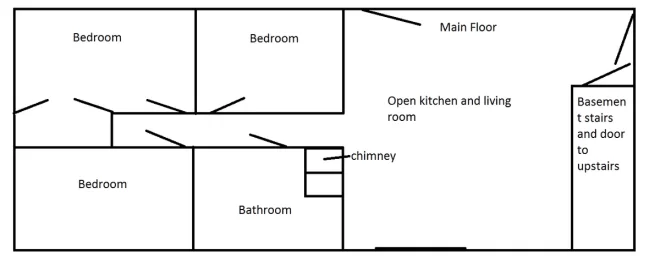

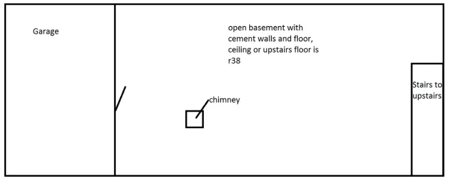

The downstairs is concrete walls and floor with r38 in the ceiling. I have attached some sketches of the floor plan, sorry I'm not good with drawing. I wish I could have it upstairs but I really don't have the space for it.

This is not a good heating scenario. The uninsulated walls are going to suck up a substantial amount of heat, up to 30% or more. The basement ceiling insulation will need to be removed. The heat that does make it up the narrow stairway will supplement only the LR and maybe the kitchen. The bedrooms will not get much at all.
Thats what I was afraid of. I wish I could fit the stove upstairs but I don't think I can fit it. Why would you recommend removing the insulation?
Because in this scenario you don't want to trap heat downstairs. You want it to warm up the floor upstairs.
Why not a stove on the main floor? The chimney can be accessed from the main floor?
If committed to putting stove in basement, how about finishing the basement, insulate walls. Remove insulation in ceiling, heat will penetrate upstairs better. Fan near the stairs?

You have a lot of doors in the kitchen/dining/lr. I believe that having the basement door open will be an incredible pain in the neck. If this were my home, I would rehang the bedroom door of the bedroom adjacent to the bathroom so it opens into the bedroom, to facilitate air movement, and I would do something about the basement door. If the stairwell is wide enough, I might rehang the door so it opens into the stairwell, thus getting rid of the duel problems of having an open door taking precious floor space in the living area, and having a door for warm air to get around to get into the living area. An option, and perhaps the best if you have small children, would be to put up a good half door, which you could leave closed. You could do both, if you want a lockable secure door to the basement when not using the stove. A half door could be made for the application, and be constructed to have alternating open and closed panels to aid in air flow. You could even have a small clip on fan mounted on the top of the half door, blowing into the basement, to encourage air flow and a nice loop of warm air rising and cold air returning to the basement.
And I definitely agree. Get the insulation out of the floor, except perhaps in the garage, unless the garage is really tight to the outside. If it isn't, get a good outdoor insulated door for between the garage and stove room. Maybe you can repurpose the floor insulation and put it on the walls in the basement?
I have mine downstairs but its a finished basement with carpet, drywall and wall insulation. My daughter has her bedroom down there, my wife has an office and our rec room, spare room and 3 piece bathroom are all downstairs. We have a dry walled ceiling downstairs but its not insulated, our stairwell is a split level style with lots of space for air to move upwards and no doors. We have plants in the area and even without fans we see the leaves moving quite a bit. Under this situation its nice to have it downstairs as my floors feel like I have in floor heating and I don't even have to wear socks or slippers in the winter because my floor is so warm. The downside to this set up for us is that if we want the temperature upstairs to be higher than 22c in the dead of winter we have a hard time getting there. That's alright with me though. Im posting this to let you know that like others have said if your basement is finished it can make a good place to put the stove and you might find you will spend more time downstairs but you have to take care of the concrete first.

I know it may be just impossible but IMHO the optimal place for a stove would be upstairs in the LR/kitchen at the right top corner of the bathroom. You could install the pipe into the back of the chimney there and have a nice central location for the stove. Something to keep in mind if you ever plan a remodel.

Everyone keeps telling him to put his stove upstairs. The room is maybe 24 x 24, has three doors and a hallway, so has the need for traffic areas. It comprises his living room, dining room and kitchen. He needs to put the stove in the basement...he is quite right. So the question becomes, what can he do to maximize heat transfer to the upstairs. Answers include getting the right stove, establishing good air movement, removing obstructions to air flow, removing floor insulation, adding wall insulation, being sure the garage is as tight as possible.

There are several factors working against this setup, an uninsulated basement, the ceiling insulation, the stairway being at the end instead of central and the door on the stairway. It may be possible to improve heat circulation by installing a floor grate toward the garage end of the hallway. Because of the noise concerns the grate should enter an insulated sheet metal box with a ducted fan attached and have an insulated duct attached. The fan would pull air out of the hallway and blow it into the stove room. The negative pressure will pull warm air out of the basement up the staircase and toward the hallway.
The caveats are heating loss, dust and noise because the stairway door would need to stay open. But after a fashion it could work. Still, there are enough caveats that it would be wise to pause and really look at all options before committing. Think out of the box. Can the workshop be moved to the garage or can a new workshop be built outside? Can furniture be rearranged or even pared down so that a stove will work in upstairs?
FWIW, we have a 15 x 17 living room with a big stove in it. We reversed the living room furniture layout to make this work. And it does work. The stove does not overwhelm the room either visually or heat wise. For a moment, consider the options and play with them. It costs nothing to make a scaled drawing of the house layout on graph paper and then cut up some squares to represent movable items like furniture, electronics and lamps.

You know your house's layout the best. This may or may not be an option. Sometimes it makes more sense to put in a new chimney if the current one is awkwardly located. Or perhaps it means extending a partition near the chimney and changing the traffic flow. I'm just guessing because we haven't seen the house and the challenges you face.
