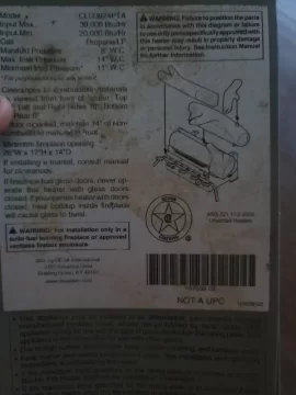

I want verification that this is a ventless gas log set. I have a wood burning chimney that is capped at the top opening. Will this work for us??
