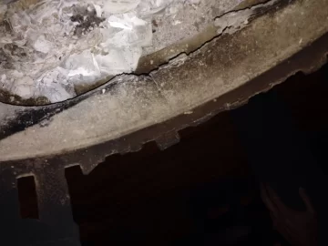

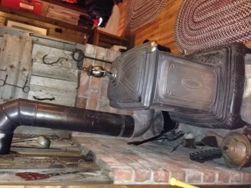

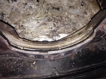

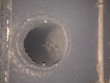

Let's see if this works....

My guess is it is just too much stove for the size of the room.
Repair the air slide, install the refractory and post instructions on stove use (small hot fires) on the wall behind the stove.
Ok there are clearance issues everywhere there. Not enough hearth protection in front of the stove to close to the back wall i would guess it is an improper wall pass thru from the looks of it. It needs allot of work not just the air slide

The longer it is there the more pyrolysis happens. It is dangerous and i would not sleep in that cabin with the wood stove burning the way it sits now.

I agree that is a problem to because smouldering fires means more creosote which means more potential for a chimney fire which means a good possibility of burning the cabin down. Again another reason i would not sleep there.
