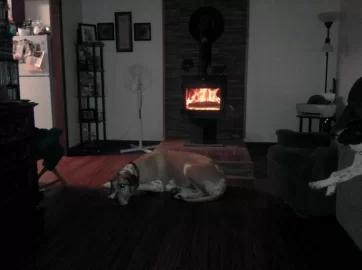

[Hearth.com] Need suggestions on raised hearth pad

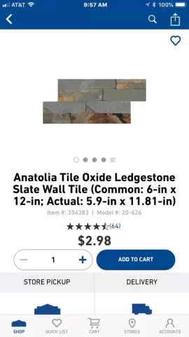

If you choose a stone look, make sure to price out local masonry places first for real stone. I found that the real stuff (I was using dark slate) was the same price as manufactured.

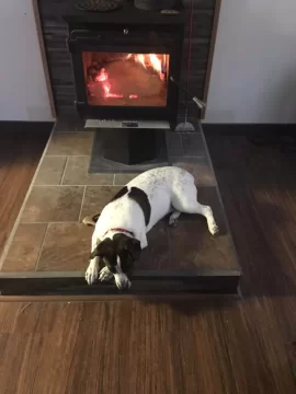

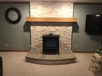

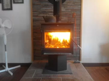

I found another picture of the whole hearth. [Hearth.com] Need suggestions on raised hearth pad

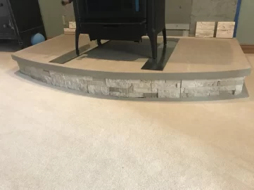

It’s a trim piece sold in the tile isle. Not sure what the correct term is. Comes in different styles and colors.

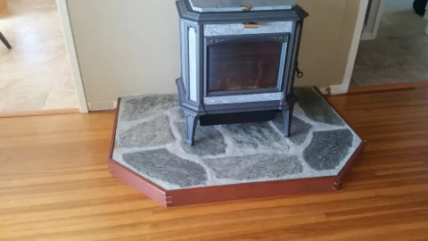

What is the small metal strip on top?
Reactions: Dmcqb

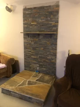

That sir is simple, beautiful and love the joinery detail.
Thank you, its turning out pretty well. The joints will be filled with walnut like in that corner and trimmed flush. But the flush trimming is proving to be a bit difficult with the already stained cherry trim. I've got a flush cut saw on the way from amazon and might have to live with the splines a little proud if I can't manage to keep the stained surface in good shape.
