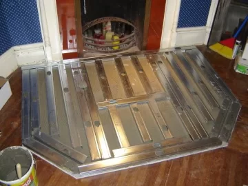

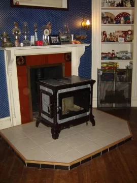

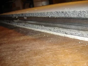

See attached images. From the floor up: 1/4" Hardi, 1/4" Wonderboard, steel studs, 1/2" Wonderboard, cheapest 1/4" ceramic tile HD sells, 500 lb stove. It's freestanding - all mortared together - only screws are holding the top 1/2" Wonderboard down to the stud faces. No cracks yet! Cost about $150 total, and I think that included the tile cutter, face tiles, trim, mortar, and the saw blade for the steel studs. R value is a little over 1.2 IIRC.
