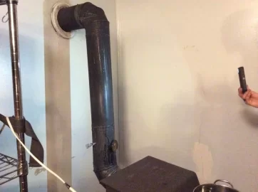

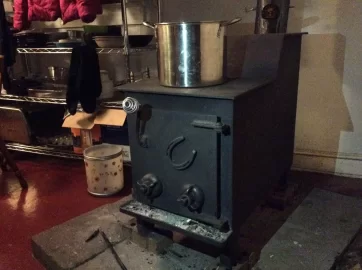

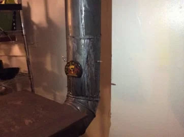

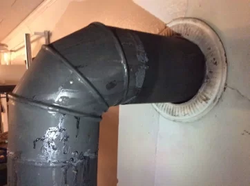

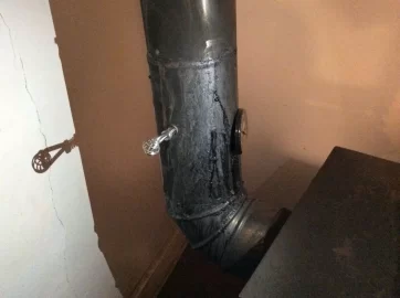

[Hearth.com] Needed, help with creosote Link Removed Link Removed I moved in about 6 months ago, and am now experiencing winter with a wood stove for the first time. I have lived with fireplaces with inserts before.
I have lots of creosote running down the outside of the stove pipe. I have replaced the old pipe and still have the problem.
It is single walled. I put the new pipe together exactly like the previous one. I added stove and fireplace cement and mortar to the fittings and three screws to each connection. I am posting pics.

Well to start your pipe is upside down.

The stove has no name or markings visible. I replaced the pipe exactly like the old one. The collar on the back of the stove could only accept the pipe female end first. Don't know the moisture content of the wood. How do you know that? I've gotten several loads of wood from different people, some seemed well cured some not so much. I've been trying to mix it.
Typical burning procedure is to get the stove up to 450-500, the creosote starts crackling in the pipe so much that hotter makes me nervous. I then close off the damper about 25%. The temp stays pretty steady, then I load in more wood about 3-4 hours later. I close off the front air inlets almost all the way before bed, then get up around 3-4 hrs later to load in more wood.
The chimney has a clay liner about 10" across I think.

The pipe needs to be installed with the crimped end down, toward the stove, so that any creosote drips in the pipe back toward the stove.
The crimped end is the same size as the collar. Too big to fit inside the collar, too small to fit on the outside of the collar. Suggestions?
Sounds like it might need a flue collar adapter.
You will have to buy or make an adapter. Looks like you will be having a chimney fire at some point. I hope your chimney can stand the heat. Probably damage it anyway. Looks like 2 things at play. You are using green wood and you have a old NON EPA stove that does not burn the smoke an have been burning it for awhile with green wood . Thats problem with those old stoves, you got to burn em hot and fast and fill em all the time. If you slow em down too much you make tar.
(Disclaimer) Its too late to burn yours hot and fast. A chimney fire will surely result.
Yeah you need better wood your burn procedure sounds about right but probably bad wood. And yes the pipe needs flipped a liner would help as well. I aslo have to ask what are the walls made of? Unless they are totally noncombustibe materials your stove is to close for sure.

Yes that is allot of creosote running down the pipe there i am sure there is also allot in the chimney. Switching the pipe around will keep the creosote in the pipe but will not reduce the risk of a chimney fire. In order to do that you need dry wood and i would have a pro come out and check out your setup for safety and performance issues
