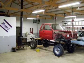

Hey everybody, im needing advise on buying an englander NC30 to heat my 36X40 (1440sq feet) shop.our shop is not the best insulated. it is all open no walls or anything. currently i have an old buck wood insert, and it burns wood as fast as i can shove it full. hahaha. no joke either. One problem i will run into is we only burn pine out here in Wyoming. Thats about all we got out here. Our wood is seasoned for 2 years so it is plenty dry. does everybody think the NC30 will be enough? ive looked at the add on furnace but dont have any duck work in the shop so it would just blow straight up. also ive never used a non cat stove so all advise, tips, tricks would be a huge help. i plan on running the blower on the stove most of the time. currently we have a heat-a-later above the buck stove now, do i need that with a new non cat stove? or would that cause problems? im thinking of the englander NC30 because of the price, but am not limited to it either. just dont want to put a super nice cast iron stove out there and have somebody grinding by it, they would probably find out what the inside of the stove looks like hahahahhaha. is there other stoves that would be around the same price that might be better? add on furnace? help please

I have a 36 x 40 x 10 metal pole barn with exposed rafters, and I heat it with an NC30. I only heat when I'm working out there. I have R15 OSB covered walls with R5 vapor barrier at the roof (more planned). I can take it from 35 to 55 degrees in about 1 1/2 hrs. with a 500 degree stove top, at 20 degrees outdoor. If I choose I can get it to 65-70...but that"s just wasting wood. A blower on the stove & ceiling fan is a must have.
The biggest heat loss battles you will have will be the ceiling/roof, and the floor. The walls are a bit easier.....you need something to block the wind/ air infiltration.
If you could do something with the insulation & the air infiltration you can reasonably do somthing with the 30. If not a furnace would probably work better. It would be easy to install a short trunk distribution system.

Hey thanks everybody for your help. sorry it took me awhile to respond. the shop is more of a hobby shop a few nights a week but most weekends im out there. to help heat up the shop right away, we got a big propane heater to knock the chill off and then the stove would do the rest of the work. i dont know how much more insulation i can do to the shop because it is steel inside and out side. but the ceiling has about 2 foot of blow in insulation in it so that helps out alot. i never thought about a ceiling fan so i might look at putting up some of those or maybe even some other fans to help move the air around better. these are all great ideas you all are helping me with, thanks a ton. looks like the NC30 might be my choice. maybe with pine i will be able to get an overnight burn if i pack that badboy full, slam the door shut and kick her down all the way. what is everybodies thought on using a heat a-later in the pipe above the stove before the 90 deg elbow? thanks so much for the help guys.
