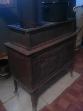

Front of the stove says nothing?
Yes, that's why I asked. It is most likely a Scandia (Taiwan) knockoff of the Jotul 118.
That's what I thought but couldn't find any info on it. The insurance is wanting the ul number but I'm guessing it doesn't have one

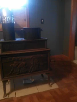

Sorry, but that stove configuration looks a little suspect. Not too sure about the wall thimble from the picture, but I think you need some better floor protection.
Perhaps someone more knowledgeable in these matters could comment.
Correct homebrewz. The hearth is not protecting at all in front and left of the stove and it's inadequate for an unlisted stove. There is metal tape on the flue pipe and it appears to be going out a window. If so and there isn't a proper thimble connected to class A chimney pipe correctly installed then this is an illegal and unsafe installation and no insurance company should insure it.
We changed all that. We did what the insurance said we needed to like double pipe going thru concrete board. Just need info on stove. It has a plate on the back but all I can read is as mechanic lab. Does this mean its ul listed?
