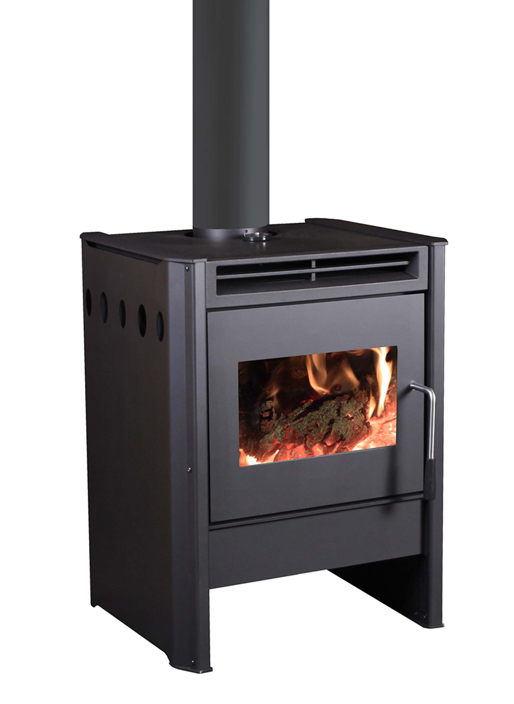

Looking to replace a Vermont Castings Aspen in the kitchen of an old farmhouse, that has minimal solar power, btw. (There's a Vermont Castings Encore in another space.) Trying to choose between the Neo 1.6 and the Novo 18. Any and all guidance much appreciated. Should I be concerned that the Novo has a blower which we may not be able to use consistently with our limited power?

Welcome Bonnie. A blower is going to help with moving the hot air faster, but it isn't always necessary. We usually only use the blower on the coldest days on our stove because the warm air convects well, naturally. Using the blower helps move more heat toward the farther end of the floorplan in the direction the stove is pointed. In our case that is the kitchen. This varies a lot with the home, stove location, and floorplan. How well did the Aspen heat the space?

I should have said: this is a 'second home' or cabin to us but we use it year-round, and we're retired. Simplicity is key because various friends/hunters/fishers borrow the place. If the weather is really cold, we would also start the Encore but if it's chilly or we're just staying for a day or two, we might just close off this room and use this one stove. We are used to the Aspen not lasting the night if no one gets up to feed it. We don't want anything larger or the space will overheat, from prior experience.

The Aspen heated the space just fine (a room about 15 x 15) but, of course, it did have to be tended. I would guess that we get 4-5 hours of burn time if we fill it wisely with embers for someone who gets up in the middle of the night to feed it.

Sorry. Haven't been on this for a long while. We got the Neo 1.6. We do like it but it is an adjustment. Loading a stove in that configuration is a little different than a long skinny one but we're learning. My one frustration is that the air adjustment from minimal to full is so slight that I can't 'shut it down' as much as I'd like. This may be user conflict in that my spouse and his friends like it HOT and I like it minimal so I would just reduc ethe amount of wood added but they often overshoot me. It also took a little learning to get it started: we now have good results by leaving the door ajar for a few minutes while it's getting started, then add another stick and shut the door. Good to go.
