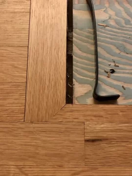

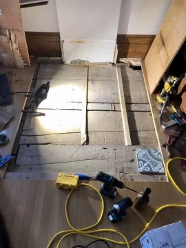

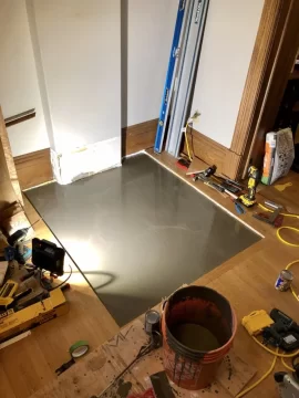

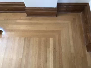

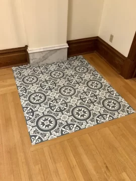

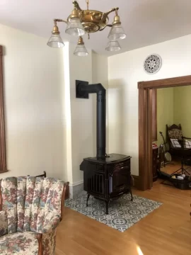

Thank you everyone, this is my first post but thanks to all your posts I ended up buying a Blaze King, and avoided a few other choices. So far so good. Chimney extended, lined (35’ of draft). I built a support beam in the basement (to support the old log sleepers), but a perfectly fine white oak floor, poured cement, and laid cement tile (and a little marble for the chimney baseboard) for a floor flush hearth.

I just finished a job with the same self leveling concrete. Recognized the blue primer. That stuff is not fully self leveling!
No kidding. The mix has a min/max water recommendation, as i learned in a small area you want closer to max so it levels better, i used a paint brush cleaner (with the spikes) to level into the corners... i also learned (the hard way) to undershoot the leveling compound by at 8th or more and use more thinset. Otherwise, magical stuff.
I was leveling the floor under a shower. A diamond cup bit on a grinder smooths it out but it’s super dusty! I used a deep notch trowel to try and spread it as I poured with Max allowable water. Still took two pours and a lot of grinding. My problem is demanding perfection.
35’ is a lot of flue. My bk is cruising along right now on 12’.
It’s a tall house. I hope it isn’t to much flu, but it isn’t letting smoke into the room when the door opens so it seems to be drafting well!

Very nice job neighbour. All you are missing now is flue thermometer.

Very nice and clean install a big stack of wood will look out of place

also that chimney is tall, i see you will have 2 90's so you might be ok, but many including me running BK's on long pipes needed some sort of damper at times to slow down the draft.
Seems to draft fine. They didn’t install an insulated liner, the chimney is in an exterior solid masonry wall (3 layers, bumped to the inside for the chimney). The tile was good but 140, so they installed a stainless liner. Flue seems to draft nicely, no smoke comes back in unless the fire went out, but i was surprised to see them install a 90.
my point is the taller stack increases draft. while the stove wont over fire like other stoves, a higher than reccommended draft can shorten burn times and suck ash up which clogs your cat. you will know when it gets real cold and the wind blows up. mine sucks air like a jet engine. yes a pipe thermometer would be a nice addition.
A fluemometer?
A probe type thermometer, 18” above the stove. I assume you have a double wall pipe. Seeing the flue temperature is very important.
Reactions: Smolder
Makes sense, when i have the bypass open i can certainly hear the suck!
Super nice install. You really took your time to mitre the marble trim. I don't know if I would have the b**ls to cut into the white oak floors.

it was scary, lol.
