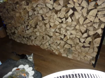

wood could be better. 15-20%, most closer to 20. I’ve been letting it char a little longer with the bypass open and that seeks to make it run cleaner after. This wood will be excellent next winter. My neighbor and I split a tractor trailer of hardwood logs then cut and split them. Might put some in the basement (it’s dry this time of year) to help pre-dry some wood.
With that moisture content, you are very close to the equilibrium moisture content in your climate. To get an accurate moisture content reading, take several big splits inside for a couple days to get them to room temp, re-split and test in the center of the fresh faces. 18% is good-burning wood.
Yeah, you have to burn in the load a bit to get enough wood gassing so that the cat has something to burn when you close the bypass. As long as you don't have the air wide open, with a roaring fire, you shouldn't hurt the stove at all. Moderation is the key.
Depending on what specie of "hardwood" you have, you might be able to stack some splits in the basement with a fan blowing on them. I got some White Ash from 25% down to 20% in a couple weeks doing that. Splits weren't big, though..
If the log load you got was from live trees, not much hope to get it dry this winter. You might do better with some <8" dead trees with the bark falling off..those will be close to dry.

I’ll definitely go check the moisture better. It’s oak, maple, and ash, but mostly red or white oak.

Hmmm. You might be crestfallen when you learn the actual moisture of some of that when you get an accurate reading, depending on how long ago it was split and stacked. Now if that's soft Maple, it could be pretty dry in a year. Another thing you might do is to get some long-dead standing Pine..that could be dry. Ignore the old wives' tale that says "Don't burn Pine, it's dangerous." Pure hogwash.
