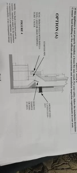

Can anyone advise what sweeping through the ss liner is like? If we use our insert daily 5-6 months/year how often are we sweeping and is that process difficult? (I realize everyone's is going to be slightly depending on wood burned and frequency)
