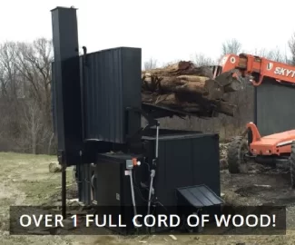

Hello everyone. Our build got delayed until this next spring so I’m revisiting this thread. IF we go with an indoor stove, we will most certainly get another Woodstock soapstone stove. We really like our current one.
That said, I think both the wife and I would prefer an outdoor stove. Well, we don’t need an outside boiler and won’t burn that much wood, so we thought about a furnace. The world of outside heaters of any kind is relatively new to me. I envision a fire chief type device but one that’s attached tot outside of the house and we load it as needed, keeping all wood and associated mess outside. I searched online and found Hyprotherm outdoor wood furnace. It looks like a small wood boiler but has no water jacket. This is more in line with what I envision. They’re only a couple hours from me. http://outdoorwoodfurnaceboiler.com/FORCED-AIR-OUTSIDE-WOOD-BURNING-FURNACE.htm?redirect=false
Are there better options? Any other brands I should look at? Our home won’t have a basement so it seems it’s either outdoor or indoor installs will be the best option.
Thanks!

You should probably start a new thread in the boiler forum- a lot of the furnace/boiler people don't read the stove forum and vice versa.
From what I've seen, expect your wood usage to increase a lot, but like you said, all the mess stays outside, and the heat is more even.

I strongly recommend you keep things simple and the original objectives in sight. That is wood heat comfort and power outage heat. A small Woodstock like the Palladian or Keystone would suffice and not need a lot of tending.
I know you’re right, I’m just trying to make a square peg fit in a round hole. If I just had the right woodworking tools.....
