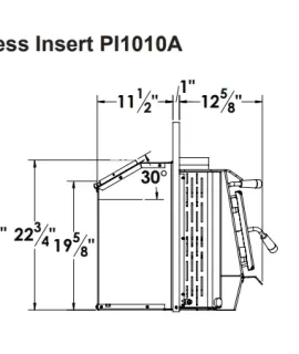

He doesn't want flush. He did like the princess except for the small glass.
The Princess is even less flush than you might expect from seeing it in a brochure, too.

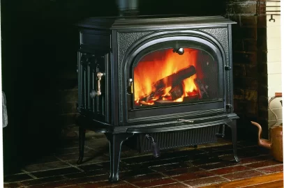

I know you said no freestanding stove but here it is anyway. Jotul F500 and F600 have a screen available to burn with the door open or removed. Pretty stove too!
