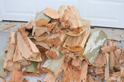

So I picked some free stuff up today. I was in my car not truck so I didnt get much. there was like 4 or 5 times what I took. They said it was sycamore. I am unsure but it was a "PITA" to split. Tho since this was the first wood I have ever split maybe this is normal.(I hope not......)
I am picking up some older oak tomorrow to split next week after work.

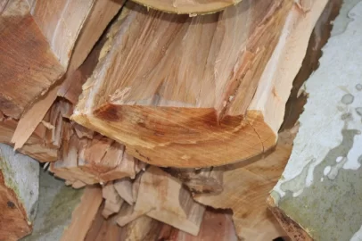

So....... is this sycamore? And if so how long to season it? I used my MM and it is at 40% right now which explains why it was so freaking heavy.
Took like an hour to split this small stack!

Sycamore is tough splitting. By next winter it will be feather light. Not a dense high btu wood, but its fine in the shoulder season. Free wood is good wood.
that indeed is syacamore...i have cut split and burnt alot of it....super dense and heavy when green...dries out pretty light...will dry out pretty good in one summer..i like to leave it in bigger splits since it will burn up somewhat quicker than other hardwoods.....burns decent....i use it when im setting around the house and can load the stove when needed..not a wood u wanna load the stove up for an overnighter..
What did you use to split with? A maul or wedges and sledge hammer? It looks like you just beat some of that wood apart instead of splitting it! I've had that happen when I'm trying to split reaction wood in Ys or where big limbs were attached to the main trunk. Sometimes that wood is so gnarly you have to resort to the chainsaw to get it into burnable sizes.
Sycamore is tough to split. The Oak will seem easy after that, especially if it's Red Oak.
Split it with a fiskers. I had 1 that was a huge round and 1 with a big knot. 2 of the smaller rounds split ok. The big round and the 1 with the knot really sucked......
If steeltown says it's sycamore, then it's sycamore !
He has processed mountains of it :)
He never complained about it being tough to split though.
Maybe you just got some gnarly pieces
Definitely sycamore. The bark is unmistakable.
Over about 30% MC, electronic meters are wildly inaccurate. If that tree was just cut down it's probably more like 80%.

I almost broke out the chainsaw but was finally able to split up the knotty piece. Took a good 15 minutes of smacking it with the axe and a couple of drinking breaks.... There was copious amounts of swearing involved too.
They don't call it Sucamore for nothing... ==c
Found a add on CL that is pretty close. They say its Hackleberry. Is it easier to split? Im not wasting my time with that sycamore anymore. There is still 3 or 4 car loads still left but I am going to ignore it. lol
Part of your splitting problem might be due to using an ax instead of a maul to do your splitting. With and ax, or a maul for that matter, it can be very dangerous with that sort of wood. When chunks start breaking off instead of splitting there is a good chance the ax or maul can make a glancing blow and end up hitting your foot or leg. I don't know if you were joking or not about taking some drinking breaks, but getting a buzz on could increase the risk when doing that sort of splitting. When I get that kind of wood, or any wood that doesn't split after a few whacks of the maul, I get my steel wedges and sledge hammer and go that route instead of hammering away with the maul. I find it takes less effort and is more productive.
Sycamore without a doubt. we have lot of those around here. We burn a lot of it since its so easily accessible. It seasons really fast.
Hackberry is just as hard to split. If you can find some walnut, red oak, post oak or sassafras-you'll feel like Paul Bunyan::-)
