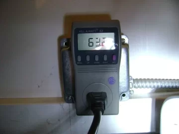

One thing you can do to help when you call for tech support, is if you are going to town, buy a meter that is known as a "kill a watt" meter.
Here's a picture of mine and what the reading was for the stove on heat setting one.
[Hearth.com] New Castle Serenity and Noisy Fan
If you can find one of these meters, it will help you diagnose a lot of things beyond the stove. But tech support can tell you if things are out of spec if you have one and know what it reads when the stove is running.

I will have to see if I can find one. That would come in handy for a lot of things lol thanks
