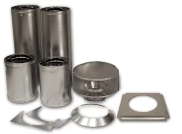

similar to whats in the house, inner pipe just slides right out.
[Hearth.com] New chimney pipe inside old chimney pipe?
what is going into the above outer pipe.
