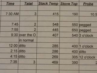

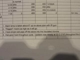

Hi Todd, tonight, on a full load, I burned at 3 for 15 minutes, then 2 for 10 minutes then turned it down to 1.5 for the duration of the (hopefully) 24 hour burn.
Basically I skipped the 10 -15 minutes at 2.5.
Also, I closed the key damper down at the beginning of the burn and won't touch it 'till sometime tomorrow. It will be interesting to see if it lengthens the burn time at all.
I certainly do have excellent draft with this SS liner setup.

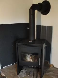

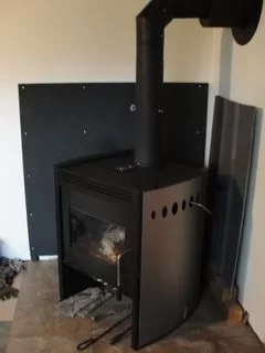

I've been racking my brain re. uploading pics and spreadsheets without them being 4 - 5 megs each.
Lets try again ..if it works you should see 2 spreadsheet pics and 2 pics of the chinook install.

What's with the wall shields? Either you meet the clearance spec or you don't.
How'd that last burn work for you? I would think a full load of Oak should go 24+.
I knew this question would come up!
I'm well beyond the clearance specs. The chinook requires only 4.5 inches from the corner of the stove to the wall. I have about 9.5"
The permanent shield was built for the Newmac stove that was installed before the BK. the side clearance was 14"--the shield reduced the clearance to 4.6"
The other "shield" is not to code and is "portable". I built it for my upstairs installation of a PE stove. It was installed to specs but the back sheet rock would overheat every time I put any quantity of wood into that very dangerous stove. The stove is long gone.. thank goodness!
I put the portable shield behind the Chinook - just 'cus I have it!! It's certainly not required/needed. The Chinook is by far the most controllable stove I've ever owned.
