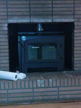

Just installed my new drolet escape 1800i. I made a fire to break it in and get rid of the paint smell. Opened a couple of windows in the living room. At 9:30pm I had a nice coalbed and decided to test the burn times. Loaded it full of dry oak and it was throwing excellent heat. I watched the secondaries for a while after slowly tapering it down until control was almost all the way in. Just checked at 1:30AM and it was still throwing heat, stove temp around 300-350 degrees and a ton of coals. From what I've read about the stove I was expecting 8-10 burn times, until around at least 6am. Could the window being open affect the burn time or is this normal to have coals after 4 hours and still put off heat for another 4 hours? Thanks

I have the same stove since last year and it averages a 6 hr burn. With 17-22% wood. Oak and maple. At 8 hrs it is pretty cold. It's just the size of the box issue.

Is your house still warm after 8 hours? Could you throw a log on and it start back up?
OK. Did somemore research. I got the stove hot as possible, quickly as possible with kindling and air wide open. it was around 650 when flames died down. Then I used the move coals forward technique, packed out the stove as much as possible, then shut it all the way down in increments as quickly as possible. Loaded it at 12:45AM, and still had tons of coals and 350 degree stove at 8:45am. Around 9:45am, it was 300 degree with enough coals to throw a log on and restart.
Would this be considered a 9 hour burn? Thanks Hearth.com!
I would consider that a solid 9 hour burn yes. Having a surface temperature of 300*F 9 hours after loading is fantastic. I myself might be replacing my smaller Drolet, with the Escape 1800 BND next season for a little extra capacity and easier loading.
