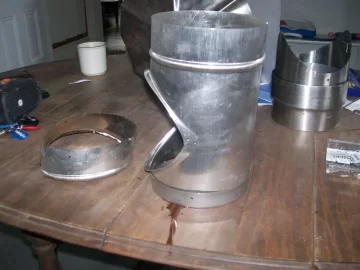

Today was the day. I think the shipment of my liner got a little delayed due to weather, but for free shipping I can't complain. First, the good. The liner arrived, and it was great and as I had discussed with theheatelement. I needed a short body tee since I have no space below the crock I passed through. Here's a picture of my crock (ignore the terrible fire hazard that it is for a moment). So I basically attached the tee to the liner before putting it down the chimney, since there was no way to install it afterwards. Thankfully it had a short, removable snout. I did have to cut the tee down even though it was a short body tee. The disc grinder and hacksaw teamed up to get it done. See picture of tee after I cut it.

So then, the install. First, it really shouldn't be done by one person. Thankfully I had a little help from my wife, but her pulling from below really didn't do much when we got snagged (a lot). I only have pictures of the easy part (the end) but here they are. note that the chimney looks really spacious, but it constricts a good bit about 4-5 feet down.
I really can't overstate how difficult this job was, standing on the roof and trying to manipulate both ends of a 30 foot liner, having to somehow twist it in just the right way to get it budge another foot. I'm glad it's done.

Now we can talk about the crock. I knew there was some masonry around the terracotta, but I was pretty sure there wasn't enough, and I also knew the mantle had to go, too. So I began to explore, and found a negligible wall patch, with the lather running right up to the crock! And yeah, it looked a bit blackened. So, wanting to burn tonight, you can see what I did. I don't have all the right clearances (about eight inches to the right, and below the stove pipe), but it's a lot better than it was. No picture of the finale, but a couple of the process of breaking away the combustibles from the brick.
Right now I'm sitting next to a toasty stove, and even though the install is ugly right now, I'm feeling like it's quite safe and will serve me fine until I get the hearth dressed up.
