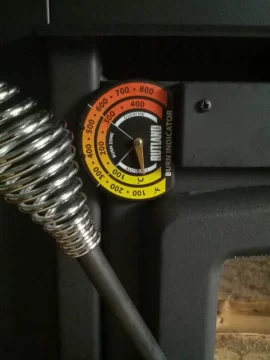

Also, I picked up this Rutland thermo. Does anyone have any experience with this model? I really wanted a Condar (based on the reviews here) but the Rutland was the only thing available locally and I just wanted instant gratification.

That thermometer seems to read a bit low - that being said you don't want to go over 800F anyway! Don't believe the overfire zone marking - I think that's a marking for when you use it on single wall pipe. Not sure about your stove (being an insert) but I'm happy as long as my stove is below 700F and it only goes above that very rarely.
Reactions: Sconnie Burner
Oh and I use a Rutland too - it was what was available locally. Mine has a sticky spot at about 325F so watch out for that. I guess I should get a condar but just haven't got to it yet...
Thanks for the heads up Cynnergy. Yes, I noticed the sticky spot right about the same spot too. Appears to stop increasing in temperature then all of a sudden it pops up about 100°. I'll in all likelihood get a Condar eventually, but I really wanted something now for the cure burns.
