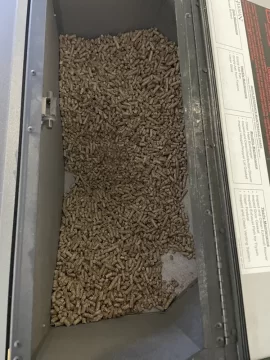

Hello all, long time lurker first time poster. Bought a new house last year that had an existing Whitfield advantage II from 1993. Worked great but with tax credits this year wanted to upgrade to something a little more user friendly for the Mrs. After reading many threads on here I pulled the trigger on a P61a. Absolutely love the stove! More heat then I could ever want and 10x less work then the Whitfield. Only complaint I have so far is that when left alone for a few hours the stove will shut it self off due to the pellets literally not falling to the bottom of the hopper. I know it sounds stupid but just wanted to see if anyone else has had a similar issue. Currently burning TSC white bag and they do seem a little more “dusty” in this batch then usual. Wondering if that’s just causing enough grip on the pellets that they’re staying stacked on the sides. Any input is appreciated! Going to attempt to add a photo to show what I’m talking about. Typically me opening the hopper lid is enough movement to make the pellets fall to the auger so that’s what’s happened in this pic.

Run it empty(well,almost). Clean really well. Then treat the sides and the slope. People do different things-- rub with wax paper, use car wax, cooking non-stick spray, silicone spray, etc,
They also make extended hoppers,to hold more.

Hu, I don't have that funneling issue with most pellets, including the TSC (which I mainly burn). Most posts Ihave seen about that issue are for pure softwoods. Although I have noticed a funneling effect on both my stoves running some Nature's own - but not to an extreme. I've herd of some people using wax, and others sanding the sides down.
Please note that I never, ever let my hoppers get as low as what you show in the picture, so that may be the reason my stove acts differently (plus, I have hopper extensions so there is a lot of weight there to help it flow down).

The pellets look huge! Maybe that's the issue. Are u use both hard and soft wood?
I agree, it could be a difference in pellets. Last pellets I burned, the bags were pretty stiff and held their shape when carrying them. Ones I burn now are like carrying a bag of water almost, they are very polished and slippery. Really had to get used to it. My hopper is steep enough to clean itself out, but if it wasn’t, these would definitely slide down easier.
If mine didn’t clean itself out, I’d be trying some of the great ideas mentioned.
