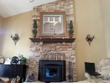

So here is the picture of chimney inside.
  • [Hearth.com] New Harman 300i Not Throwing Out Enough Heat

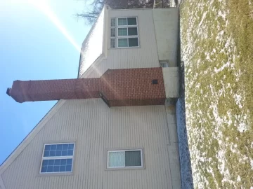

Picture from outside.

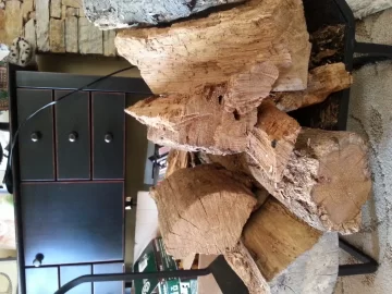

Here is the sample of firewood I use.

Looking at your pic, I am guessing all the brick expose to the outside cold is acting as a giant heat exchanger, helping transfer heat produced by the insert to the great outdoors. This could be a factor even with a block-off plate, but would be MUCH worse without one.
In addition to asking about the block-off (I assume there is none) ask if there is any insulation of the fireplace itself, behind the stove. One thing worth noting about Harmans is that the secondary burn takes place in the rear of the stove, so their inserts really depend on the blower moving that heat out. Obviously whatever heat is being lost to the masonry/outdoors cannot be transferred by the blower.

That wood looks great, should be heating you up. I fear it is the installation that's the problem.

That's a large mass of masonry exposed to the outdoors. An insulated block-off plate will raise the output temperature significantly. If there is room, slipping some non-combustible insulation board behind the insert will also help.
The other issue is the room design. Get on a ladder and measure the temp up high near the peak. I think that is where a lot of the heat is. Do you have a ceiling fan running in reverse in this room?

On a side note, I put up a picture of how the chimney looks from outside, and there is a wrought iron grate, which I can open and look within, which is the back of firebox itself. I reached in and felt the bricks are slightly warm to the touch. Not sure what that indicates, but something interesting.
