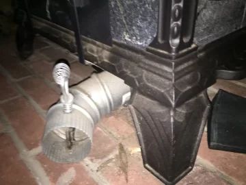

The stove has a pipe stubbed out in the back already. Do I need something else to hook up some flex pipe to it? I will take a pic later and post it.
Here is a picture of the back of the stove
[Hearth.com] New Hearthstone Mansfield
That's what I thought. I might slip it over it and run it to a plastic window insert that came with an air conditioner I have. The insert allows you to close the window on it to reduce airflow.
I'm not real sure what you have here, but I wouldn't want to have a partially open window for this purpose.
The piece seals the window off While allowing me to hook the outside air to it. I'll try to send a picture later.
I think this would work. I like the fact that after the burn season I can unhook everything and put it up. No permanent holes. [Hearth.com] New Hearthstone Mansfield
Interesting, it still seems to me that it would leak a lot of air.
I might try to put weather stripping around the edge. If it does leak a lot of air I will go back to square one.
I think you should keep in mind fresh air kits should not rise above the bottom of the firebox.
The stove is on a raised hearth and the windows do sit lower. So wouldn't be a problem. I'm curious now. Why would it matter? Am I missing something simple?
