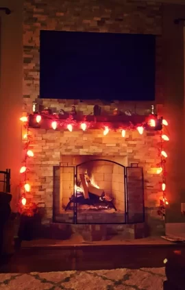

We recently moved into our new home and have now had our third fire. Last night, our fire alarms went off because of the smoke. It happened again tonight. What in the heck is wrong? The flue is open all the way. We had wood delivered and at first I thought that the wood may not have been seasoned enough. I went and bought one of those little packages at the gas station and the same damn thing keeps happening. Any thoughts?

It is a masonry fireplace. We will check for daylight tonight when we get home.

It should not be setting off the smoke detectors. There may not be a simple answer. Does this only happen on startup? If so, the chimney may be cold. Make sure that the damper is opening fully and the wood is seasoned. There are some physical possibilities like the flue size being too small, or the opening height being too high. You can check both of these by measuring the fireplace opening size and the chimney flue liner size. As a temporary test you could tape some aluminum foil so that it drops down the opening height by 4-5" and see it that makes a major improvement.

It does not only do this on start up, last night it took about a hour or so before the smoke started to accumulate in the house. I also notice it when I add a piece of wood to the fire and/or stir up the wood that is in the fire. I will track down some 100% seasoned wood from a friend. Could you try and explain the aluminum foil test a bit better? 34w x28h x19d is the size of the fireplace opening. my husband will have to get on top of the chimney to see the size of the flue liner, we can't get to it from the inside. do most flue's these days open by pushing up? Our house growing up had one that pulled down.

The foil thing will tell us if it is a problem with the fireplace design either because the ratio between the liner and firebox opening are off or the damper is not high enough above the top of the opening.
Not sure how your flue damper control works. It's best to look up into the chimney and see which way opens it up fully.

We can only push the damper up, not down. Silly question, is there a youtube video that shows what you mean to do with the tinfoil? I'm not sure that I'm following.

Probably not. It is just for testing. Take a roll of tin foil and tape it so that about 5" hangs down in front of the fireplace opening, all the way across. This will effectively reduce the fireplace opening from the current 28" high to 23" high.

That is a check to see if there is negative pressure in the house. Modern construction is often very tight. If so, or if there is an HRV system or an exhaust fan running in the house it could be causing negative pressure.

ok, that makes sense now with the tinfoil, thank you! So if we find this solves the smoke issue, what does that mean? We are fireplace virgins. Do any of you have fireplaces without doors? I was hoping to keep it open for looks, but we may need doors??

If any of these things fix it it will tell you what the problem is. You can then go to your builder as nd make them fix it.
Opening the windows tells you if your problem is with air intake to the fireplace. A tight home might not let enough air in, so it limits your exhaust. Same thing if you have other exhausting appliances (water heater, dryer, bathroom fans, etc) running at the same time.
