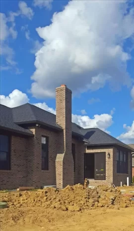

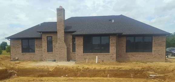

Have a picture of the chimney coming out of the roof ? I would have the builder come look at this fireplace (like bholler said) then ask why you are having problems.
  • [Hearth.com] New home with open fireplace fire alarms
The builder has stated that he believes the issue will be resolved if we put doors on the fireplace. Is this true? Would the doors help with the draw issue?
