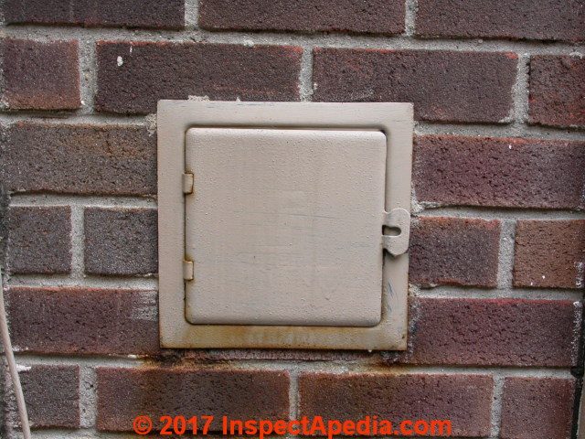

Maybe we should have asked first: is it a brick chimney? This is generally what a cleanout door looks like at the base of the chimney. My dad's chimney has two, one for each flue.

If it's just a stove pipe running up through the middle of the house, then you won't see a cleanout door like this. You should, however be able to see if there is more than one pipe coming out of your roof (one for each stove). If not, you can direct vent the pellet stove pipe out through an exterior wall somewhere else. There are setbacks for windows and doors and stuff like that.

That is typically a cleanout for a masonry chimney
each chimney will have one
If one is in use for your central heat other if not used can be for the pellet stove
Have it checked to make sure it is in good condition and clean

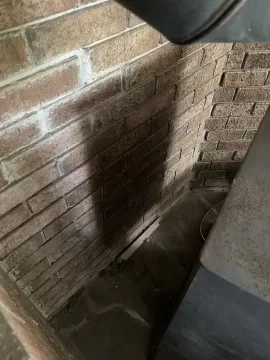

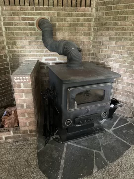

1. First 2 pics are the basement wood stove and the only visible part of the chimney base.

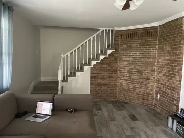

2. The upstars living room, directly above the wood stove. The brick wall is basically the middle part of the chimney.

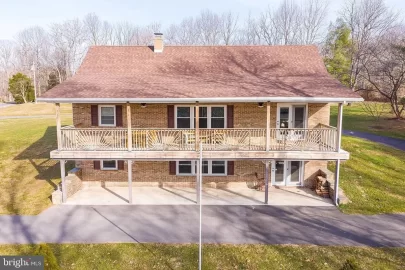

3. An aerial view of the outside of the house, with chimney location. If you follow the chimney down to the second floor, the brick wall directly below it would be where the venting pipe would exit, if the chimney was not an option.

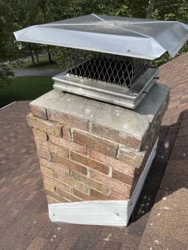

4. Close up of the top of the chimney. Its just an open space as far as I can see down, which is not far at all. I wasn't prepared to remove the top. Also, just FYI for everyone, the chimney had some touch up work done a year or so ago, and I believe it was serviced in the last 2 years as part of a previous house sale.

From your photos, you only have the one flew
Will need to vent up through the roof or our
the side or back wall or last resort out and up
through the porch roofs

100% correct and if you read in any stove install instruction manual, it plainly states that a pellet stove cannot use an existing flue that another stove uses.
You are gonna have to vent is separately, through the roof or through the wall. Your other option is to remove the wood stove entirely and vent through there with a flexible liner to the top of the chimney.
Kind of an interesting arrangement on the wood stove too. I would have come straight up with a single 45 to the wall thimble and put the damper in the vertical. The more elbows you have the more ash collects in them.

Looking at your chimney you may want to have a mason come and rebuild the upper part. You can see where it has been patched several times... This is going to lead to a early failure and water intrusion causing the brickwork to fail and cost you more money
Thanks for the advice, I never would have known otherwise. Do you have any idea how much it might cost to have a repair down by a professional?
