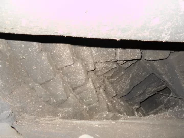

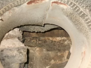

Hello, I am a new first time homeowner and within a few months of moving in to my house (built in 1915), I had a the chimney swept by a CSIA listed company and they didn't raise any issues with the masonry fireplace but did make a complete mess of my first floor-- there was soot everywhere that we spent the day cleaning up. In any event, my wife thought it made sense to have another company come out and take a look and do an inspection to make sure the fireplace was safe. I scheduled the appointment but in the meantime tested the chimney with some incense first and then a small fire followed by a couple larger fires. The smoke went up the chimney and all seemed to be in order. Just had the inspection and the inspector said I have some holes in some spots (images below) and he recommended "smoketite" at a cost of 1275 plus a cement gap at lintel for 250. I have no clue whether any of this is necessary, and plan on having a second opinion, but wondered if any of you experts had any thoughts based on the attached images. Also, he recommended completely changing my dryer vent and doing some video inspection to reline the natural gas boiler flue -- his description of the issue on that flue was "gas flue 4" 76,000, 7" 245,000 is not lined at base must be video scanned for relining. Not safe to use." He didn't give me an image for this one. Thoughts comments etc very much appreciated. Many thanks.

If it is your intent to keep this and use as a fireplace I would continue on with the second opinion. It does appear that there is some weak points in your chimney setup, but I won't even speculate to what degree. It needs professional eyes on it.

Old chimneys need a lot of upgrades to keep them safe if they have not been maintained well in the past. It would be wise to have the video (level 3) inspection done to make sure everything is ok and another opinion. I had it done on my 1950's chimney and they found issues that had to be fixed.

Depends - if you go with a simple liner you will still need to have any "breach" of the chimney fixed first. Insulated liners are pretty much a stand alone system. I would still get a pro second opinion. No matter which direction you go, if it were me - I would want the piece of mind that I am starting with a chimney that is in good shape.
