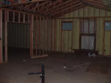

Ok, so first off, great site! We are building a custom home on property and due to the plentiful supply of firewood, we wanted a wood burning insert for supplemental heat (well, probably more for aesthetics than heat to be honest). The house is all framed now and our builder assured us we would save some money going with a framed chimney with a stainless liner instead of masonry, which was ok since nobody is ever going to see the back of our house anyway. On the inside however, the opening is all wood framed as well. I was surprised when the builder said we are ready to purchase the insert and install it, as I expected it to be at least masonry on the inside. He said for gas and wood inserts, they always do wood framing with a faux masonry front.
I know very little about inserts, so I would appreciate any thoughts on this. Is this safe? Do people normally install inserts in to non-masonry "fireplaces"?
We were looking at the Lopi Freedom Bay or the Quadra-Fire 5100, if that helps.
I am attaching a picture of the room as it sits today. That opening is 42" wide, by 24" deep.
Thanks all,
-Jeff

I have a stainless steel insert and the only masonry is the concrete of the fireplace and the tiles of the hearth. The stainless steel insert should be double-walled with either solid insulation between the layers (helps keep the inside surface hot but is more expensive and maybe more fragile) or air between the layers. The outside of the insert is cool enough to not burn down your house.
We encounter this terminology problem almost daily. An Insert can only be installed inside an existing fireplace. For a wood-framed chase, you need another beastie entirely, called a zero-clearance fireplace. These are made to be installed in combustible enclosures, and vent using insulated chimney pipe, not chimney liner.
The Lopi Freedom Bay and Quadrafire 5100 are both inserts, and are not on the menu for you unless you want to build or buy a fireplace to insert them into.
There are several high-efficiency zero clearance wood fireplaces in the marketplace. Check out:

All, thanks for the quick and very helpful replies. It seems that indeed there was a terminology mismatch between the builder and ourselves. I specifically asked for an insert like the ones I listed when we were in the design stages, yet the builder interpreted something else entirely. Being that this is certainly not my area of expertise, I didn't even think about it while the subs were framing.
Thanks again for all the great info though. Looks like I am going to have to go another direction now. Thanks for the suggestions!

You cannot install the inserts you mentioned in a wood framed area. I would guess/hope your builder plans to put in some kind of factory-build fireplace into which you would then install the insert you pick out???
This can be a problematic installation, as I can guarantee you that the manufacturer of the factory-built unit has not tested or listed their fireplace with any other manufacturer's inserts. The factory-built fireplace's chimney pipe is rarely the appropriate kind, either. Since you're at the framing stage it would be a simple matter to install an EPA/Washington State certified fireplace and be done with it, and that's what I'd advise if you were my client.
Your Lopi dealer probably carries Fireplace Xtroardinair and Quadrafire makes one too. You might check some other brands as well - RSF, for example, has a nice lineup including two models with fairly small fireboxes (a real consideration, since these things are SERIOUS furnaces).

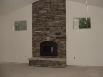

Well gang, here is an update. We finally got our zero clearance fireplace all installed and the masonry up. Thanks so much for educating me on this subject. I learned a lot. We decided on the Heat N Glow NorthStar model. Here is a picture of it almost finished. Thanks again!
  • [Hearth.com] New house and probably a really dumb question
Beautiful installation Jeff! I like the keystone over the stove. Nice touch!
