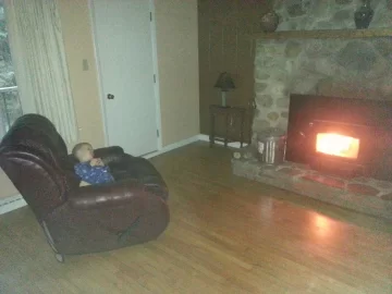

I posted a few months ago regarding an older masonry fireplace and installing an insert. In short, we were given a $6000 rough quote which would cover the install costs and the cost of the insert(at the time undecided on the which insert). We had just purchased the house and money is tight so I set out to do this for under $1000.
I got really lucky and picked up a CW2500 on CL for under $300. Bought the SS liner, cap and 45* adapter. Oh and $20 for the thermostat...
$434.94 for the liner kit
$275.00 for the insert
$20.00 for the thermostat
$729.94
Picture was taken with my camera phone, it doesn't do too well in the dark. The room isn't smokey, that's just an exposure issue. One of my helpers enjoying the fruits of our labor:
