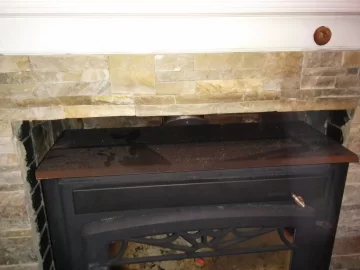

Hello,
I just bought an insert and had it professionally installed, however, I'm barely getting any heat from it. I bought a Majestic Windsor WR2500X02. I know I bought an entry level model, but I was told that it would still heat the area. My house is at most 1100 sq ft. and at about 12ft away where the thermostat is, I struggle to keep the temperature at 20°C. I can only keep that temperature with the blower set to max and let me tell you, it's loud. The burn time I get out of a log is roughly two hours.
I went to the shop and they said to make sure that I'm burning dry seasoned hardwood. I am, however, when I call them back, I'd like to have at least a bit of knowledge as to what I'm talking about.

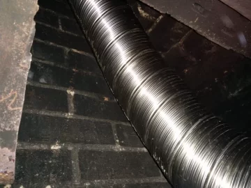

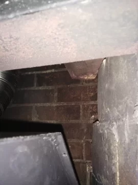

When the installers came, they had to break out the back of my fireplace because the flue wouldn't fit since it comes out of the back of the unit on a 45° angle. I've seen some threads here where people have plates and insulation around the flue, however when I took the surround off of the insert and stuck my phone back there to take pictures, There is just open chimney.
The guy at the store said that he couldn't see that being a problem, but I don't really buy it. Anyway, I'm just wondering what some of you folks think, or if you have any ideas as to why I get no heat. The installers said that with the (small) size of my house, it should get ridiculously hot in this room, but it just isn't the case.
I've uploaded some pictures for you to see what I'm talking about. If anyone has any ideas, it would be great.
Thanks. [Hearth.com] New insert, no heat[Hearth.com] New insert, no heat[Hearth.com] New insert, no heat[Hearth.com] New insert, no heat
You need an insulated block off plate. That alone will make a big difference in your heat getting into the room.

Ok, so the consensus is a block off plate. I suppose to seal in that whole area they will need to build up the back wall too. Thanks everyone. I just want to be able to come to them with something so I know some of what I'm talking about.
If a blocking plate is made, is sprayfoam a suitable way to insulate the gaps? Or is something like Roxul better?

If you are going back to the store/installers to request the block off plate installation you might find them offering to just stuff the open areas with insulation and telling you that is good enough. I wouldn't settle for that solution since a lot of heat will still seep through insulation if you don't have a solid block off plate reflecting the heat back into the room. I'm not sure about stuffing insulation, meaning Roxul type product around the insert since some inserts are designed to have an air envelope around them and not touching anything. I'd check further before doing this so that you don't run the risk of damaging the insert from over firing.
x10 on the plate.
I'd say almost certainly all your heat is going up the chimney for sure. As everyone has said: shove a ton of roxul up there, and install a block off plate. That liner isn't insulated either... Is your chimney on an outside wall of your house? If it is the block off plate will help, but draft and creosote can be a problem with an unlined liner you want basically insulation around the entire flex liner.
I didn't read rest of replies so if this was said. After one season of burning these guys are right. If the wood is not right either are the results. I have mixed wood. Some perfect some not. I can tell exactly which group I dug Into by the heat and the way the fire works. If everyone had seasoned wood I think a lot of people would be getting bored on hearth because there would be very few "problems" to solve! Lol
If you can't fabricate a block off out of metal. Use roxul for the time being, it works great! Pile it up into the smoke chamber and then make a plate out of roxul. Its rigid enough to hold itself in place just cut it several inches larger than the area. Then when you have time make one out of thin sheet metal. I made a template out of cardboard then used that to make a metal one. The metal one is too thick, like 1/8" and it not very forgiving when working in low clearance. SO I used the metal one as a template for the roxul and its great. I've been using the roxul one for almost 2 years and it works so well I never made a metal one. Others may argue but it works better than nothing and works well for me and others I've done this for .
Im with Plays with Fire, I stuffed mine with Roxul and never saw the need to put up sheet metal.

So the service guys came and stuffed five sheets of Roxul back there. I was kind of annoyed because they didn't take the insert out and do it properly. I could have done that, but either way, it's in there now. They insisted that it's all they can do. When I asked why the chimney liner wasn't insulated, he said they only insulate it at the top.
So if it works, I'll leave it for now and fix it myself this summer. If not, I'll be taking it back I suppose. I just have to wait for a cold day. Unfortunately, it doesn't look like there's one in the forecast for a few weeks.
