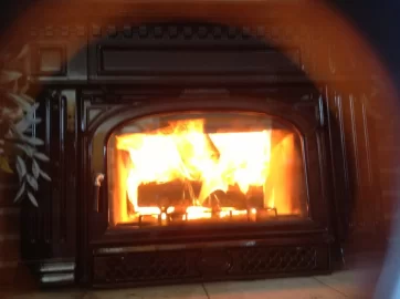

Well I was gonna g o for the i300, till my wife found the montpelier, we got the upgraded surround in enamel brown, it looks totally awesome and I am very happy with what I have, if you compare them both, i300 numbers seem higher with the btu, but in a sense, they are both medium sized inserts, which are only capable of doing so much with their heating capacity, meaning, both are not house heaters. Which brings up a point that you said,you want supplemental heat and the view, both will give you that. I went with the montpelier because it has a bigger glass viewing area, 280 sq in. I was with my 10 yr old sweetie daughter hanging by the fire and watching tv, she says that the flame look like they are coming out of the glass. The montpelier really gives off a great show. I300 probably does too but I can't vouch for it, also there is no lines in the glass that would take away from the view. All I'm saying is that if you like the i300, then check out the montpelier before you make a purchase. People are saying VC will or is being sold, some negativity, but I'm happy with mine, I got it in the end of January and its been fired up 4-5 days a week till the warmer weather kicked in.... Anyways good luck....

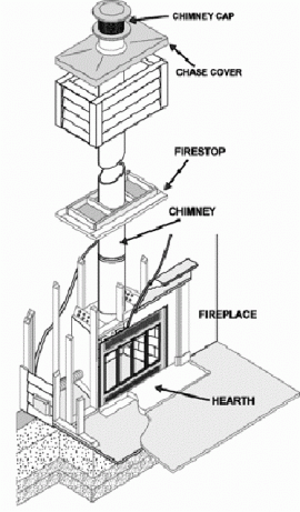

Look at the image below. It shows all of the components of a factory built zero clearance unit. Since you are starting from scratch you can use just about any pre-fab/zero clearance unit. Once you see what is involved you can start looking at units based on heating requirements and appearance.

Inserts are great, but this is not the right application for one. As others have said, go with a high efficiency fireplace. This is the kind of unit you would build around. Inserts slip into existing fireplace. You don't have an existing fireplace.
If you go with one of those inserts like the Regency (and some from Travis also can be used) that can be installed in a zero clearance fireplace, you'll have to get both the insert and the ZC fireplace.

YES, it is out of the question. Lining the chase will not be sufficient, to use an "insert" you need an existing fireplace. There are many zc factory built fireplaces to choose from. Stop by a stove shop, tell them you are starting from scratch, you have no fireplace, and let them explain what you need to do.
